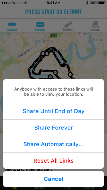

- Customizing Your Share Link
You now have options to decide who can track you and for how long. This gives you better control over your privacy and helps you share the information important to those users.
With customizable link sharing, you can:
- Share Until End of Day: This allows you to create a time-sensitive link that will expire at the end of the day.
- Share Forever: This is a special permalink that gives permanent access to your location anytime you turn on your ELEMNT bike computer and enable Live Track.
- Share Automatically: This will provide a link automatically anytime you turn on your ELEMNT device. You can choose where you share it (Facebook, Twitter, and/or Email), and it’ll expire at the end of your ride. You will need, however, to designate which email participants will receive the link via the button at the bottom.
- Reset All Links: Expire all active links instantly. It’s important to note that you’ll need to share “forever” links again to those partners if this option is chosen.
