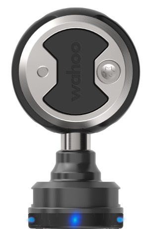

SPEEDPLAY POWER
SPEEDPLAY POWER combines accurate power measurement with the proven SPEEDPLAY platform, helping cyclists train smarter, track progress, and maximize performance.

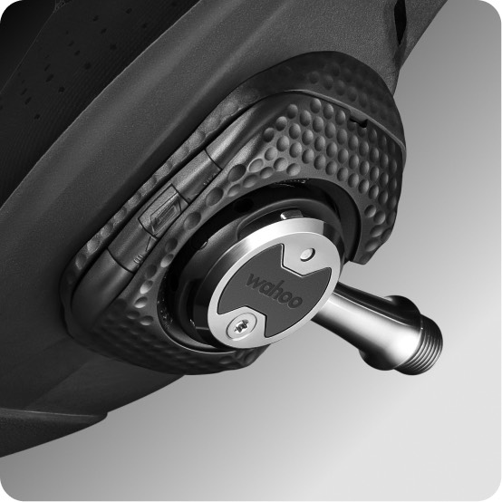

SPEEDPLAY Aero
- Spindle: Stainless Steel
- Weight: 224g

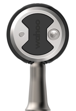

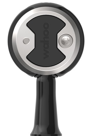

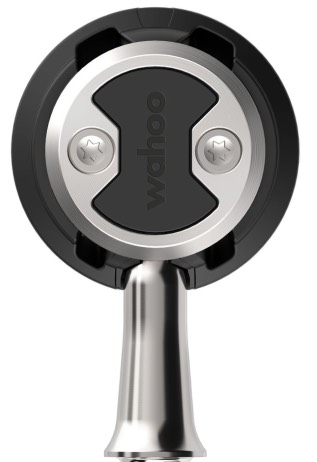

SPEEDPLAY Power
Built on the cutting-edge SPEEDPLAY platform, Wahoo SPEEDPLAY POWER pedals deliver reliably accurate power data in a race-proven system.
- Weight Single: 250g
- Weight Double: 276g

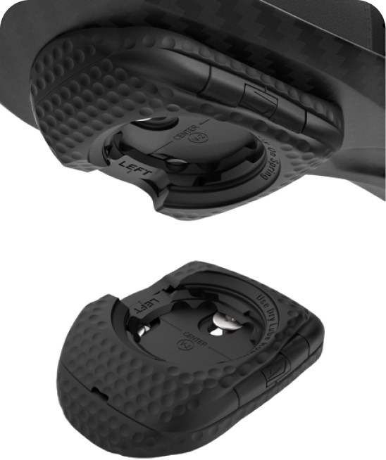

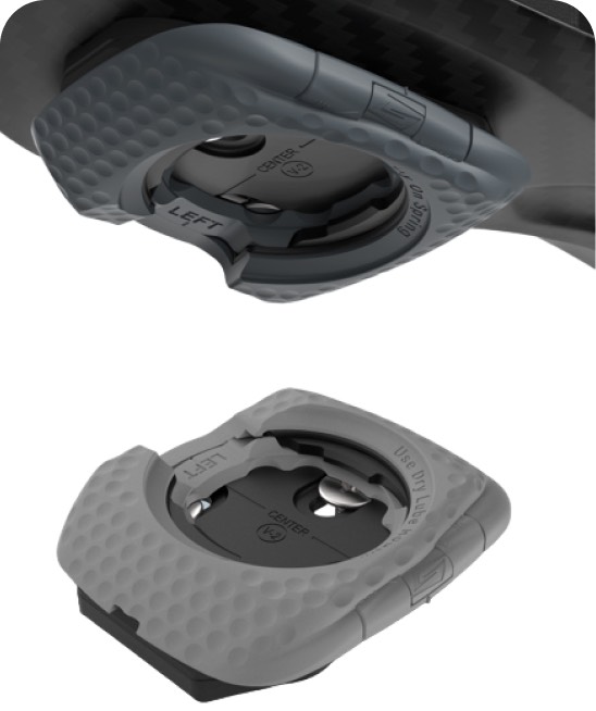

SPEEDPLAY is more than the iconic dual-sided pedal. It’s an integrated pedal + cleat system that gives each set-up its unique advantages. And it all starts with the cleat.

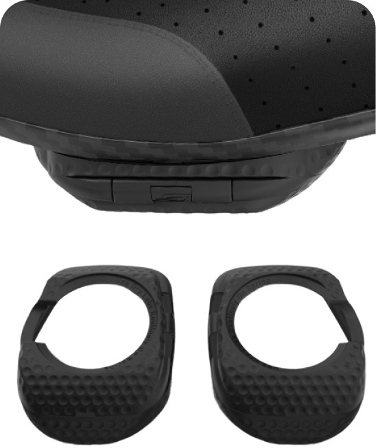

Standard Tension Cleat
Easy Tension Cleat
Walkable Cleat Cover Kit
SPEEDPLAY Walkable® Bike Cleats are the first truly walkable road cleats. The integrated, rubberized covers stay on the cleats while you are riding. When walking, the covers improve traction and protect the cleats from wear.

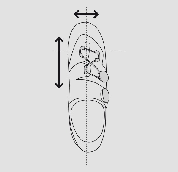

What is float, and how do I adjust it on SPEEDPLAY pedals?
Float is the degree your heel can pivot while clipped in. Some float protects knees from the stress of a fixed position; too much can feel vague. Most pedal systems make you choose float by buying different cleats. SPEEDPLAY cleats are micro-adjustable from 0 to 15 degrees with independent control of inward and outward rotation, so you can dial in exactly the range your knees need. Setup steps are in the pedal support center.
What is the difference between Standard Tension and Easy Tension cleats?
Standard Tension cleats hold the foot with full-strength spring engagement, the right choice for racing and hard efforts out of the saddle. Easy Tension cleats use light-action springs that reduce the force needed to clip in and out, ideal for new riders, riders with knee concerns, or anyone who prioritizes easy exit. Both versions fit every current SPEEDPLAY pedal, and both are walkable with the integrated cleat surround.
Can I walk in SPEEDPLAY cleats?
Yes. Current SPEEDPLAY cleats have an integrated rubberized surround that covers the metal engagement hardware, so you can walk into a cafe without skating on metal. For longer time off the bike, snap-on cleat covers protect the cleat mechanism from grit and wear. Keeping dirt out of the cleat springs is the single best thing you can do to keep engagement crisp.

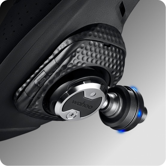

SPEEDPLAY POWER Pedals
Should I choose single-sided or dual-sided power?
SPEEDPLAY POWER SINGLE (£479.99) measures power from the left pedal and doubles it, which is accurate enough for consistent training at a lower price. SPEEDPLAY POWER DUAL (£679.99) measures each leg independently, giving true total power plus left/right balance data, valuable for bike fitting, injury rehabilitation, and riders whose balance shifts under fatigue. If you are buying your first power meter primarily to train with zones, SINGLE does the job; data-focused riders should choose DUAL.
How accurate are SPEEDPLAY POWER pedals?
SPEEDPLAY POWER pedals are accurate to +/-1%, in line with the best power meters at any price. An internal gyroscope measures true cadence rather than estimating it, and automatic temperature compensation keeps readings stable as conditions change mid-ride, whether that is a mountain descent or a hot indoor session on a KICKR trainer.
What is the battery life, and how do they charge?
SPEEDPLAY POWER pedals run up to 75 hours per charge on a built-in rechargeable battery, so there are no coin cells to replace. For most riders that is one to two months of training between charges. LED indicators on the pedal show battery, power, and connection status at a glance.
