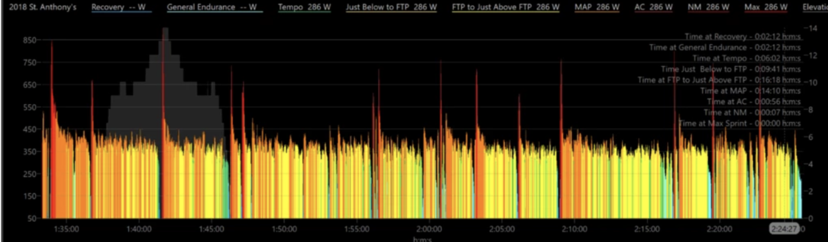

To illustrate this point, let’s look at the power output of Cameron Dye during the 40km bike leg of the 2018 edition of the St Anthony’s Triathlon, where he placed third. In the graph below, light to dark yellow represents efforts right around FTP, with Maximal Aerobic Power (MAP) efforts in orange, and Anaerobic Capacity (AC) and Neuromuscular Power (NM) in red. As you can see, well over 20% of the bike leg was spent at intensities above FTP.

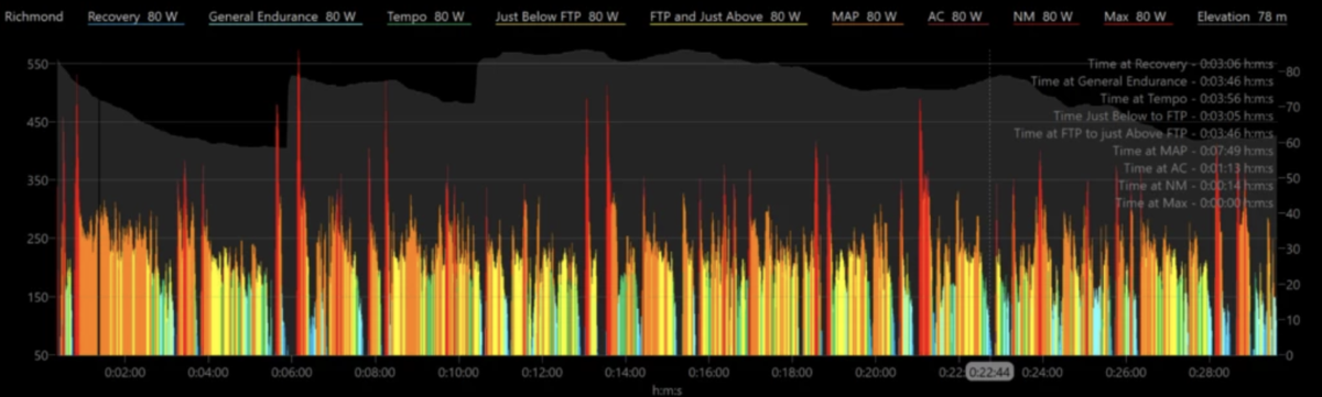

And here’s an example of power output from an ITU Draft Legal Sprint Podium Finisher. Note that less than a quarter of the bike leg is spent at or near FTP, with efforts at MAP intensities accounting for a full 20% of the time spent on the bike.

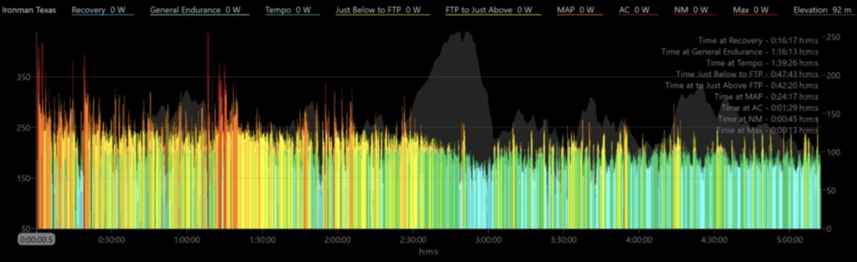

And this from a professional triathlete’s 4th place finish at IRONMAN Texas. You can see that pacing to catch up to the leaders in the first half of the race required lots of MAP and FTP effort before the athlete settled into a sustained General Endurance Tempo effort for the second half of the bike leg to save energy for the run. That’s over 24 minutes at MAP intensity out of the five hours spent on the bike.
