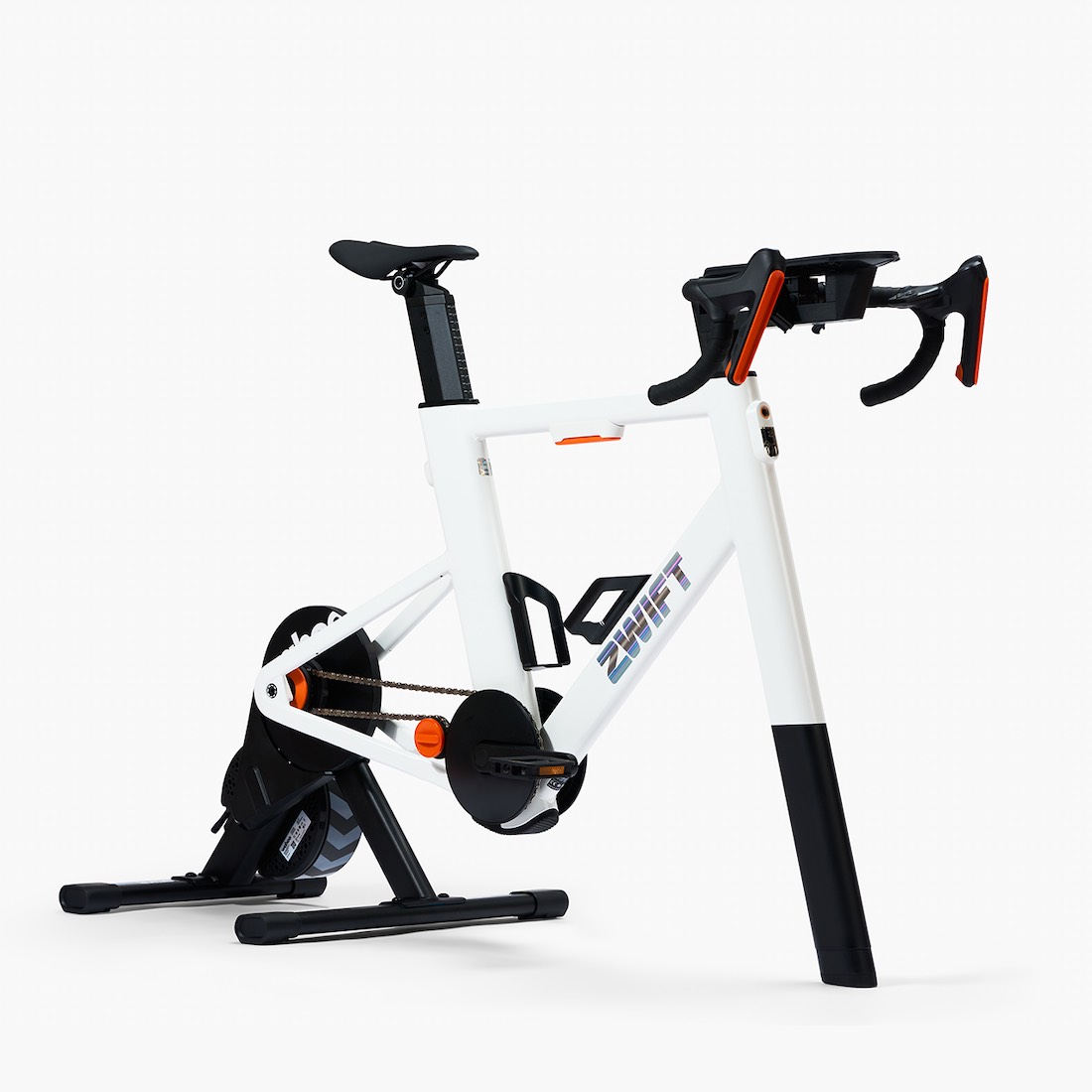

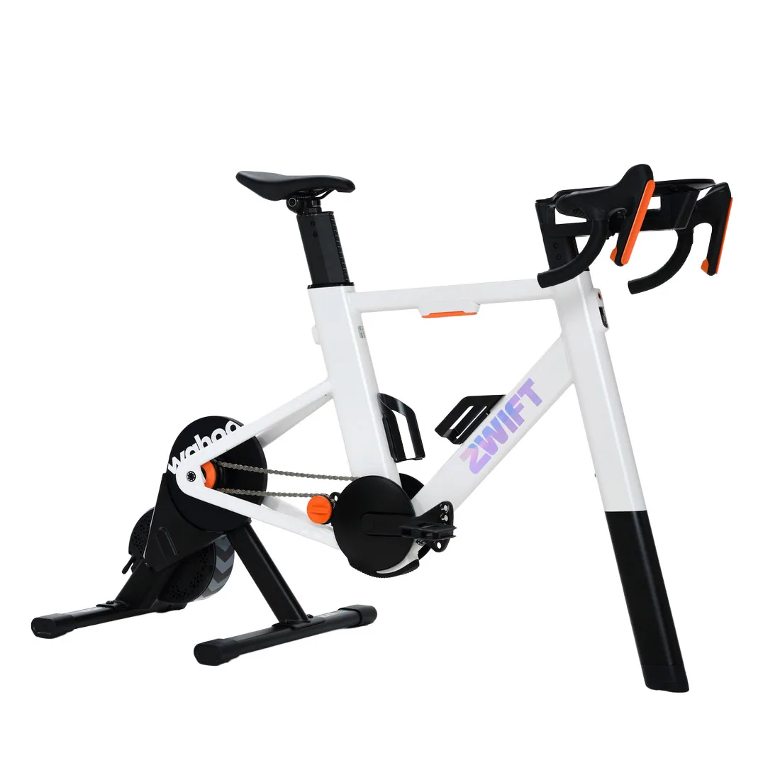

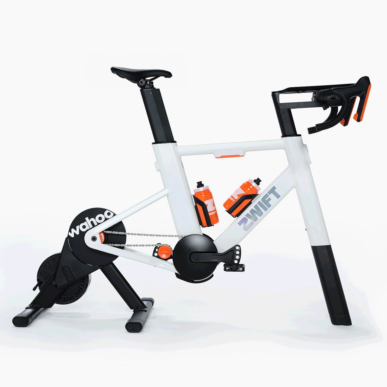

Zwift Ride V2 with KICKR CORE 2 offers an all-in-one, complete setup to unlock the best virtual experience in the worlds of Zwift and ROUVY. The proven KICKR CORE 2 smart trainer sets the foundation for responsive resistance and reliable power, paired with the Zwift Ride Smart Frame to enable seamless control of your Zwift riding experience at your fingertips.
Designed with simplicity in mind—a single tool that stows away on the frame is all it takes to assemble, dial in your bike fit, and adjust between users. Zwift Ride includes all of the hardware you need to get started on Zwift.
Zwift Ride has been updated to include multiple crank lengths, more saddle adjustability, and redesigned, larger-diameter handlebars, making it easier than ever to get set up, get comfortable, and start riding.

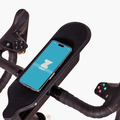

  • Handlebars: Broader tops for riding comfort

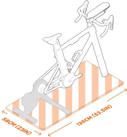

  • Product Dimensions: 53.5 x 23.75 in / 135.9 x 60.2 cm

  • Handlebar Controllers: rechargeable, about 20 hours per charge (USB-A, 5V, 1A)

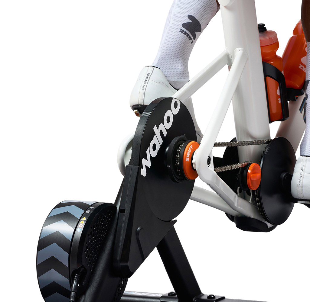

  • Zwift Ride V2 smart frame paired with a KICKR CORE 2 and Zwift Cog
  • In-game gradient changes drive the trainer, up to 20% up and -15% down
  • Handlebar controllers queue workouts, fire PowerUps and send RideOns without pausing

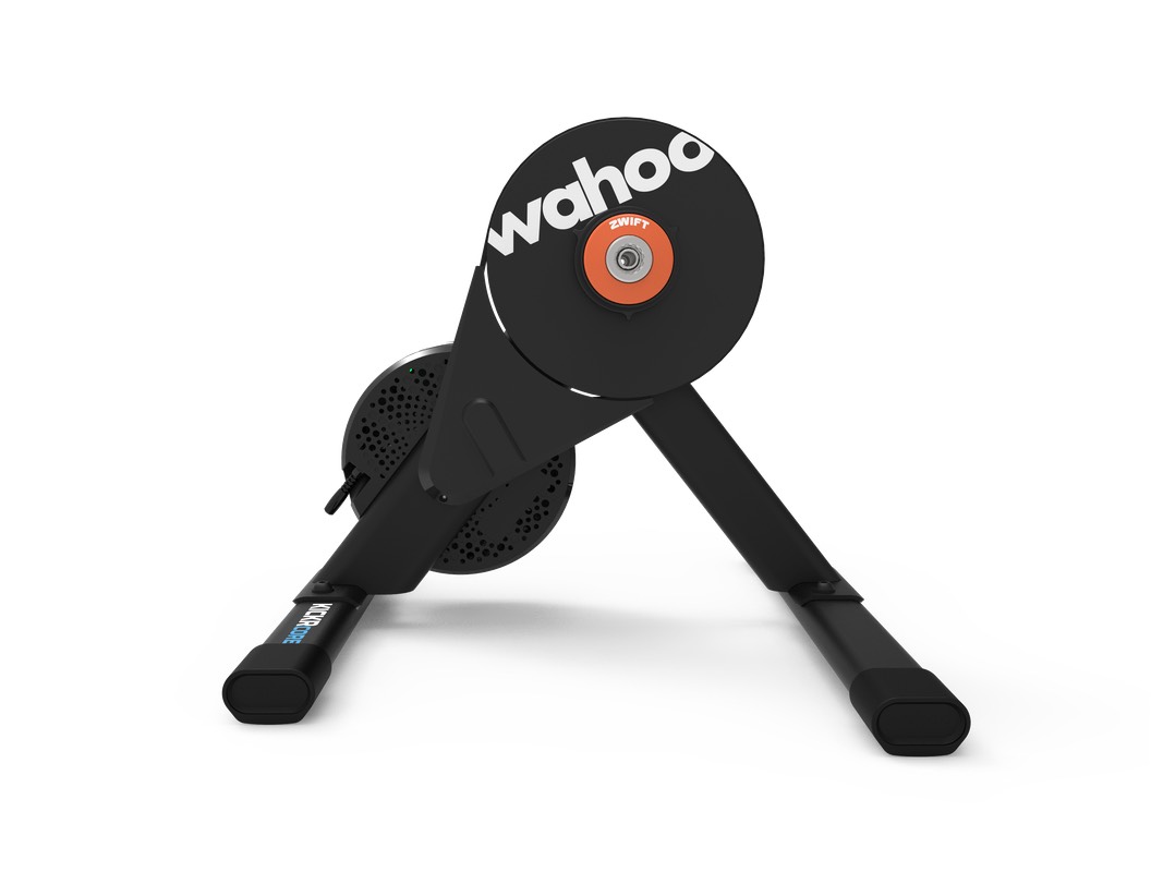

KICKR CORE 2 Features
Controlled resistance
WiFi & Bluetooth Connectivity
KICKR Bridge
Professional grade durability
Race Mode
Race Mode
Updated LED System
Updated LED System
What's Included
Smart trainer with Zwift Cog
WAHOO KICKR CORE 2

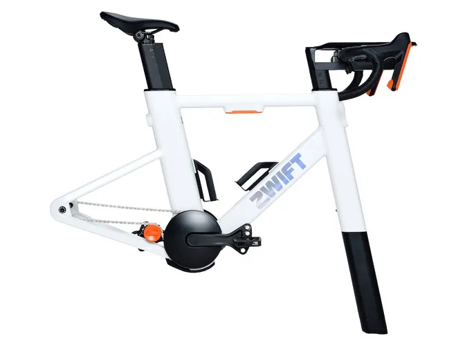

Frame with integrated controllers
ZWIFT Ride V2 Smart Frame
  • Handlebar with Controllers
  • Thru Axle
  • Allen Key
  • Phone Tray Mat
  • Frame Key
  • Left & Right Pedals
  • Charging Cable for controllers
  • Cable Tidies

Rider Fit Specs
  • Rider Fit Range: 4 ft 10 in - 6 ft 6 in (147 cm - 198 cm)
  • Saddle Height Min-Max: 22.5 - 34.1 in (57.1 - 86.5 cm) (center bottom bracket to top of saddle)
  • Stepover Height: 28.7 in (73 cm)
  • Max Rider Weight: 264.6 lbs (120 kg)
  • Crank Length: 160/165/170/172.5/175 mm
Product Dimensions and Frame Specs
  • Product Dimensions: 135.9 cm L × 60.2 cm W
  • Product Weight: 35.4 kg
  • Drivetrain: Chain
  • Pedals: Flat Included (compatible with standard road and mountain pedals)
  • Saddle: 160mm W x 245mm L

  • Product Dimensions: 53.5 in L x 23.75 in W

The Zwift Ride V2 bundle now comes with the upgraded Wahoo KICKR Core 2 trainer, replacing the original Core. While the smart frame itself remains unchanged—still offering built-in controllers, virtual shifting, and full rider adjustability—the Core 2 adds major enhancements. Key upgrades include WiFi connectivity for seamless updates, Race Mode with faster data transmission, KICKR Bridge for sensor consolidation, improved stability with redesigned legs, clearer multi-color LEDs, and a refined flywheel for a more realistic ride feel. Since September 2025, all new Zwift Ride V2 bundles include Core 2, giving riders a more connected, responsive, and reliable indoor cycling experience.
