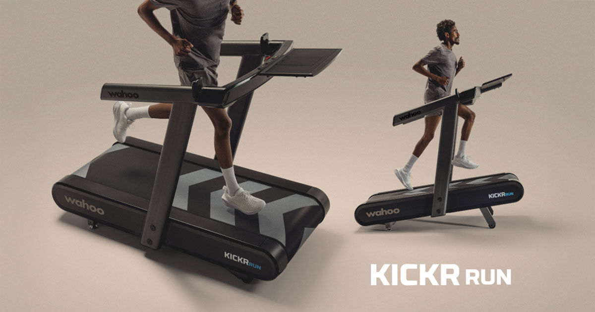

Where KICKR RUN fits
KICKR RUN is a great choice for this kind of session.
Incline to 15%, decline to -3%
The 15% ceiling leaves three points above 12-3-30, so there is somewhere to progress to. It is not the steepest treadmill sold, and several incline trainers go considerably higher. The decline is the rarer feature: KICKR RUN drops to -3%, which makes downhill work possible at all, something neither Peloton Tread can do.
RunFree hands-free pacing
A time-of-flight sensor tracks where you are on the belt and matches speed to you, so there is no reaching for a console mid-session. Since reaching for the rails is the main thing that undermines incline walking, a treadmill you do not have to reach for helps. You can cap the top speed.
Automatic Grade Control
The grade shifts on its own through a structured workout or a simulated route, so incline intervals run themselves. Manual control is a button away.
Cadence, ground contact time and vertical oscillation
Streamed without a separate sensor. On incline work they are the objective read on whether you are doing the work or gradually handing it to the handrails.
No subscription on the hardware
RunFree, grade control and the metrics work from day one. Route Simulation and structured workouts come with a Wahoo App subscription, and the treadmill also runs with Zwift, Kinomap, Humango, Peloton and MyWhoosh.
Note: Check one spec first: KICKR RUN takes users up to 250 lb / 113 kg, which is lower than some alternatives. Incline walking is popular with people starting out, so it is worth confirming before ordering.
$6,999.99 / £5,999.99, including in-home delivery and setup, with a two-year warranty.
